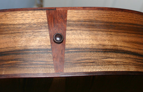

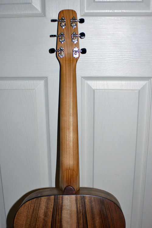

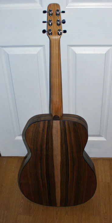

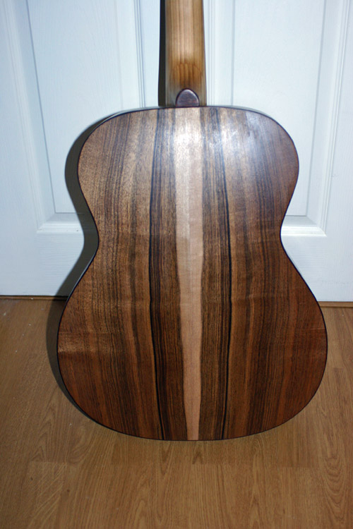

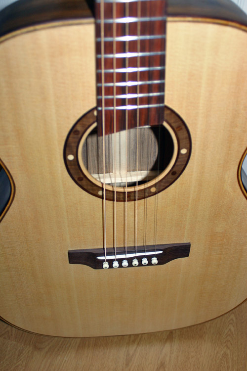

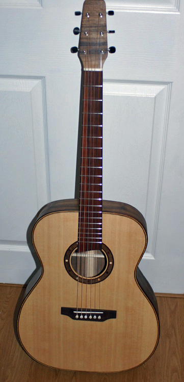

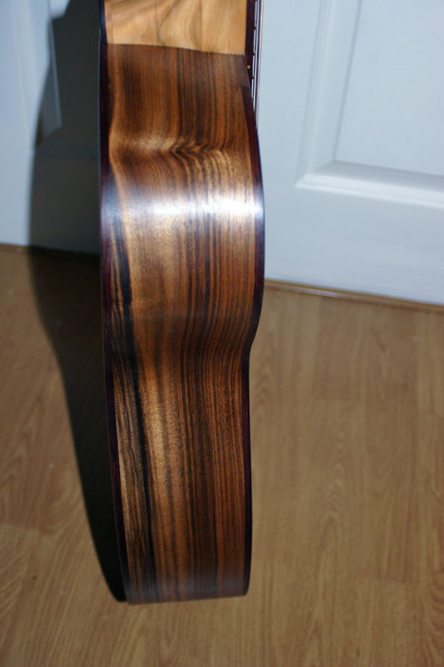

First of all apologies for the photography I took them !
My wife will take some nicer shots tomorrow.
A Few Details
Lutz/English Walnut OM
Mad Rose Fingerboard
Brazilian Bridge
Madrose Bindings
Walnut and Satinwood Purfling
Waverleys
24.9" Scale
Cherry Neck

What a pristinely made guitar! Such balanced design.. I really like the attention to detail with the Madrose fingerboard and bindings.
I'm hoping to make a cherry neck next build...it sure does look good.
PostPosted: Wed Oct 11, 2006 8:18 am
Russell, great looking guitar! I really like the choice of MadRose for the bindings, they're sweet. I also think your neck design looks really cool!

What do you think of the Lutz? I really like it both tonally and visually, and found it a lot easier (dent wise ) to work with than Euro. It's a credit to Shane.Dave White39002.1103819444

I love that cherry neck!

You have the nicest walnut wood in Old England.

That is a beautiful instrument! What finish did you use? it really shows that walnut to a beautiful advantage!

The mad rose bindings, the rosette, the fretboard, That Lutz/England walnut, this guitar is just stunningly beautiful!

I really love that walnut... Very beautiful stuff...

PostPosted: Wed Oct 11, 2006 5:48 pm
Well Done Russ,
I too like the cherry neck and that shot of the side with the wayne in the grain (good name for a band ) makes me dizzy. And at the risk of sounding repetitive, I also really like the satin finish.

I delivered the guitar this evening and got the oppurtunity to hear it played in anger for an extended period. First of all the quality of shanes Lutzs is just out of this world, this was one of his AAA tops, Soundwise I don't think it has the same distinct seperation that I get with Euro, but to me it is warmer sounding with a nice clear projection. (If that makes any sense, I am struggling to put into words what I'm hearing ) Working wise you are right it is more resiliant, or though I recently got some Euro from Luigi in Italy and this is noticebly harder than the Swiss European I get from Touchstone. I haven't completed a guitar with Luigis spruce yet but it is lovely and stiff and beautifully quartered.

Chris/Alain
The Finish is Danish Oil, applied over shellac
Carlton
The guy who supplies me cherry say I drive him crazy as between Colin and I we take the best parts of the log and leave him with the problem of selling the rest.
